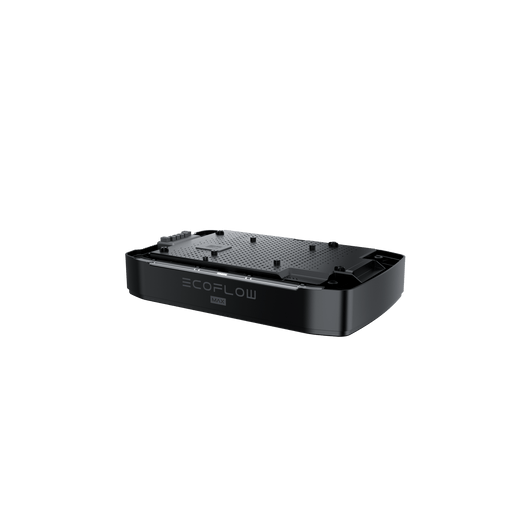

How to install EcoFlow RIVER Extra Battery?
1. Please make sure that the EcoFlow RIVER is turned off. Take out the screwdriverfrom the extra battery module kit and locate the four screws on the bottom cover.
Note: Please pay attention to prevent static electricity during the installation process.
2. Please remove the 4 screws and the bottom cover. The extra battery module should be positioned as shown in the figure.
3. Align the male and female battery sockets and connect them. Close the bottom cover. Take the four long screws from the kit and screw them on the screw mouth.
4. Put the EcoFlow RIVER upright and turn it on. The extra battery's ambient light will turn on. If the extra battery module indicator light is shown on the EcoFlow RIVER 's display, it is activated successfully. If the ambient light or the extra battery module indicator light is not active, repeat the installation steps and then check the connection.
